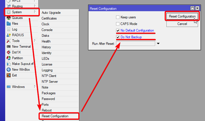

The easiest method to ensure a completely clean router is to run the CLI command
/system/reset-configuration no-defaults=yes skip-backup=yes
Or from WinBox:

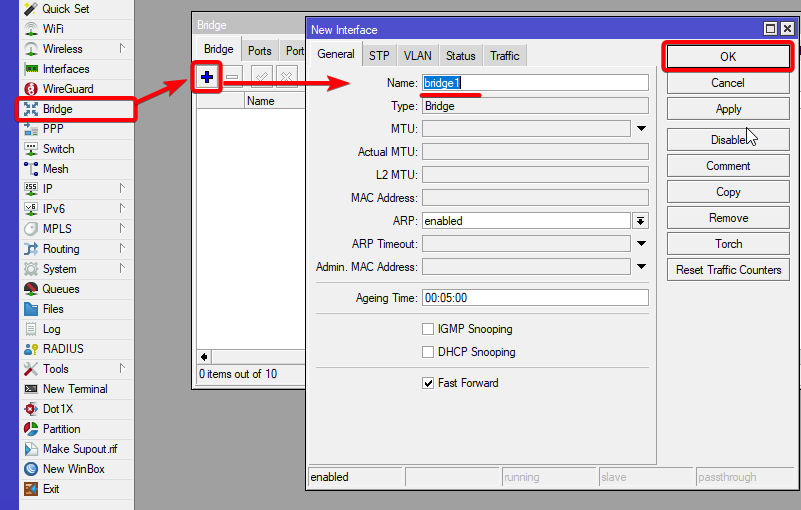

Setting up the bridge and assigning an IP address are straightforward processes. First, create a bridge interface and add the desired Ethernet port as a bridge port:

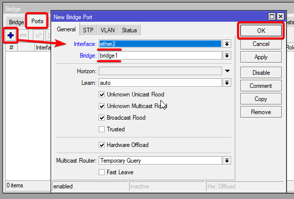

/interface/bridge/add name=bridge1
/interface/bridge/port/add interface=ether2 bridge=bridge1
/ip/address/add address=192.168.88.1/24 interface=bridge1
If you prefer WinBox/WebFig as your configuration tool:
  • Open the Bridge window, ensuring the Bridge tab is selected
  • Click the + button to open a new dialog box. You can either enter a custom bridge name or retain the default bridge1, then click OK to proceed
  • Switch to the Ports tab and click the + button to open another dialog box
  • Select interface ether2 and bridge bridge1 from the dropdown lists, then click OK to apply the settings
  • You may close the bridge dialog

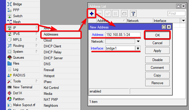

  • Access the IP menu and navigate to the Address dialog
  • Enter IP address 192.168.88.1/24 and select interface bridge1 from the dropdown list
  • Click OK to confirm the settings

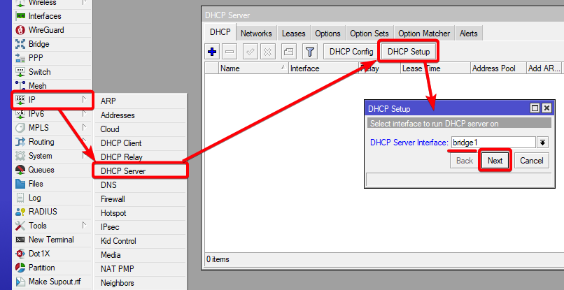

Next, proceed with setting up a DHCP server. To simplify and expedite this process, execute the setup command:
[admin@MikroTik] > ip dhcp-server/ setup [enter]
Select interface to run DHCP server on
dhcp server interface: bridge1 [enter]
Select network for DHCP addresses
dhcp address space: 192.168.88.0/24 [enter]
Select gateway for given network
gateway for dhcp network: 192.168.88.1 [enter]
Select pool of ip addresses given out by DHCP server
addresses to give out: 192.168.88.2-192.168.88.254 [enter]
Select DNS servers
dns servers: 192.168.88.1 [enter]
Select lease time
lease time: 1800 [enter]
Notice that most of the configuration options are automatically determined, so you simply need to press Enter to accept each value.
The setup tool is also accessible in WinBox/WebFig:
  • Navigate to the IP → DHCP Server window, ensuring the DHCP tab is selected
  • Click the DHCP Setup button to open a new dialog
  • Select bridge1 as the DHCP Server Interface and click Next
  • Follow the wizard to complete the setup

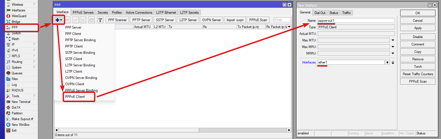

PPPoE Connection
PPPoE (Point-to-Point Protocol over Ethernet) connections also provide a dynamic IP address and can automatically configure DNS servers and default gateway settings. Typically, your Internet Service Provider (ISP) provides you with a username and password to establish the connection.
/interface/pppoe-client
add disabled=no interface=ether1 user=me password=123 \
add-default-route=yes use-peer-dns=yes
PPPoE Connection Setup
PPPoE (Point-to-Point Protocol over Ethernet) is commonly used by DSL providers and requires a username and password to establish the connection. This connection type provides a dynamic IP address and can automatically configure DNS server and default gateway settings.
Winbox/WebFig Configuration Steps:
  1. Open the PPP window and navigate to the Interfaces tab.
  2. Click the + button to add a new interface.
  3. Select PPPoE Client from the dropdown list.
  4. Enter a name for the connection and select ether1 as the interface.
  5. Go to the Dial Out tab and enter your username and password provided by your ISP.
  6. Configure any additional parameters as required by your ISP.
  7. Click OK to save the settings.
warning
After configuration, the WAN interface becomes pppoe-out1 instead of ether1. Use this interface for all subsequent WAN-related configuration.

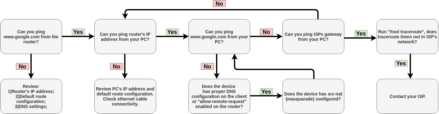

Verify Connectivity
After completing the configuration, verify that the router can access the internet. Test IP connectivity by pinging a known IP address, such as Google's public DNS server at 8.8.8.8.
[admin@MikroTik] > /ping 8.8.8.8
SEQ HOST SIZE TTL TIME STATUS
0 8.8.8.8 56 55 14ms399us
1 8.8.8.8 56 55 18ms534us
2 8.8.8.8 56 55 14ms384us
Successful ping responses indicate that the router has internet access and the WAN configuration is working correctly.
Verify DNS Resolution
After confirming IP connectivity, verify that DNS resolution is working correctly by pinging a domain name:
[admin@MikroTik] > /ping google.com
0 142.250.74.14 56 55 14ms475us
1 142.250.74.14 56 55 14ms308us
2 142.250.74.14 56 55 14ms238us
If both the IP ping and DNS ping succeed, your internet connection is fully functional. If either ping fails, refer to the Troubleshooting section for assistance.

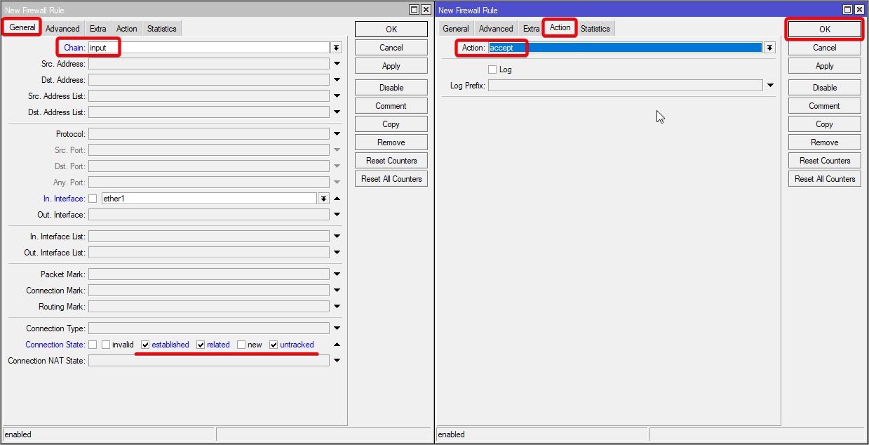

tip
If you have set up strict firewall rules, then the RDP protocol must be allowed in the firewall filter forward chain.

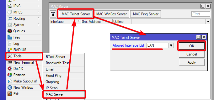

MAC Connectivity Access
By default, the MAC server runs on all interfaces. To restrict MAC connectivity from the WAN port, disable the default "all" entry and create a LAN interface list instead.

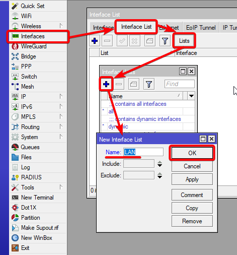

First, create an interface list:
[admin@MikroTik] > /interface/list/add name=LAN
Then, add your previously created bridge named "bridge1" to the interface list:
[admin@MikroTik] > /interface/list/member/add list=LAN interface=bridge1
Apply the newly created interface list to the MAC server:
[admin@MikroTik] > /tool/mac-server/set allowed-interface-list=LAN
Do the same for Winbox MAC access:
[admin@MikroTik] > /tool/mac-server/mac-winbox/set allowed-interface-list=LAN
To configure MAC server access control using WinBox or WebFig, follow these steps:
  1. Navigate to InterfacesInterface ListLists.
  2. Click the + button to create a new interface list.
  3. Enter "LAN" in the Name field and click OK.
  4. Return to InterfacesInterface List.
  5. Click the + button to add a member to the list.
  6. Select "LAN" from the List dropdown.
  7. Choose "bridge1" from the Interface dropdown.
  8. Click OK to confirm.
  9. Open ToolsMac Server.
  10. Click MAC Telnet Server.
  11. In the dialog, select "LAN" from the dropdown list.
  12. Click OK to apply the settings.
Repeat the same steps in the MAC Winbox Server tab to block MAC Winbox connections from the Internet.

IP connectivity on the public interface must be limited in the firewall. We will accept only ICMP (ping/traceroute), IP Winbox, and SSH access.
/ip/firewall/filter
add chain=input action=accept connection-state=established,related,untracked comment="accept established,related,untracked"
add chain=input action=drop connection-state=invalid comment="drop invalid"
add chain=input in-interface=ether1 action=accept protocol=icmp comment="accept ICMP"
add chain=input in-interface=ether1 action=accept protocol=tcp port=8291 comment="allow Winbox";
add chain=input in-interface=ether1 action=accept protocol=tcp port=22 comment="allow SSH";
add chain=input in-interface=ether1 action=drop comment="block everything else";
danger
If the public interface is PPPoE, LTE, or any other type, the 'in-interface' should be set to that interface.
The first rule accepts packets from already established connections, assuming they are safe, so as not to overload the CPU. The second rule drops any packet that connection tracking identifies as invalid. After that, we set up typical accept rules for specific protocols.

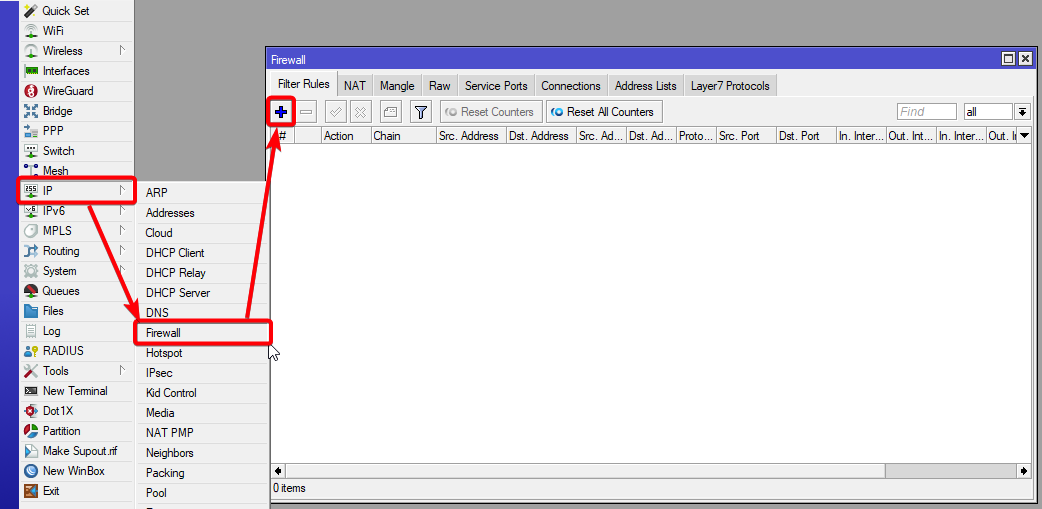

If you are using Winbox/WebFig for configuration, here is an example of how to add an established/related/untracked rule:
  • Open the IP -> Firewall window and navigate to the Filter Rules tab.
  • Click on the "+" button to open a new dialog.
  • Select "input" for the chain.
  • Click on "Connection state" and check the boxes for "established," "related," and "untracked."
  • Go to the Action tab and ensure that "accept" is selected.
  • Click on OK to apply the settings.
To add additional rules, click on the "+" button for each new rule and fill in the same parameters as provided in the console example.

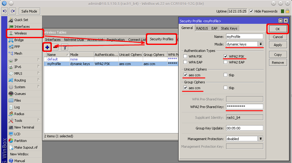

Setting up Wireless
To simplify network management, a bridged wireless configuration is recommended. This setup places your wired hosts in the same Ethernet broadcast domain as wireless clients, allowing seamless communication between all devices.
The first and most critical step is to secure your wireless network by configuring a security profile. This prevents unauthorized access to your network.
Configure the security profile using the terminal:
/interface/wireless/security-profiles
add name=myProfile authentication-types=wpa2-psk mode=dynamic-keys \
wpa2-pre-shared-key=1234567890
Alternatively, in Winbox or WebFig, navigate to the Wireless window and select the Security Profile tab.
If you have legacy devices that do not support WPA2, such as Windows XP systems, you may also need to enable WPA protocol support.
danger
WPA and WPA2 pre-shared keys must not be the same.

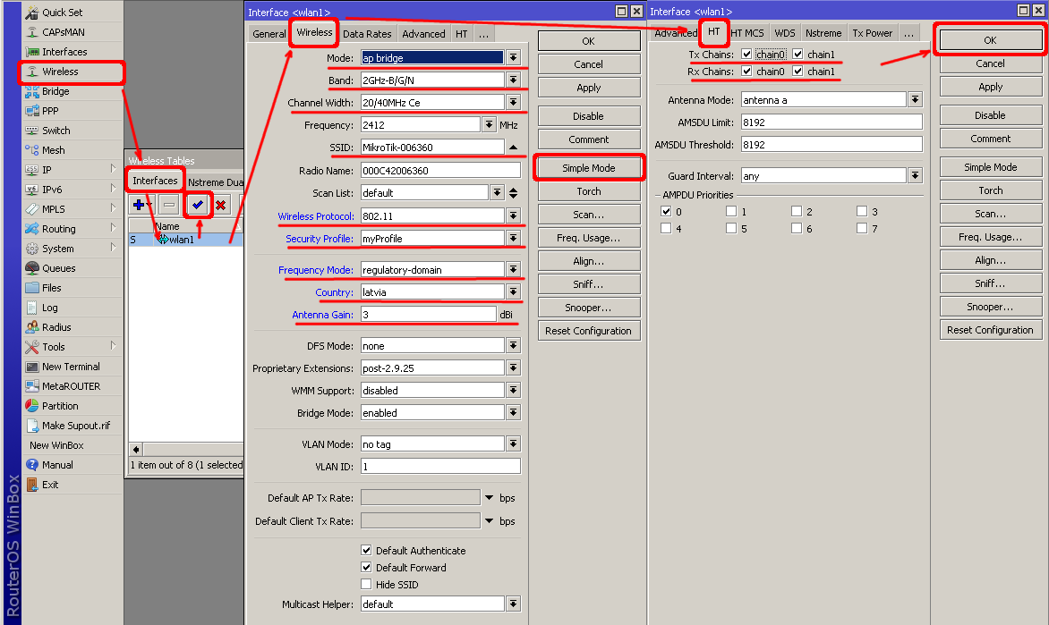

Once the security profile is configured, enable the wireless interface and set your desired parameters:
/interface/wireless
enable wlan1;
set wlan1 band=2ghz-b/g/n channel-width=20/40mhz-Ce distance=indoors \
mode=ap-bridge ssid=MikroTik-006360 wireless-protocol=802.11 \
security-profile=myProfile frequency-mode=regulatory-domain \
set country=latvia antenna-gain=3
To configure the same settings using Winbox or WebFig:
  • Open the Wireless window, select the wlan1 interface, and click the enable button.
  • Double-click on the wireless interface to open the configuration dialog.
  • Click on the Wireless tab, then click the Advanced mode button on the right side. Additional configuration parameters will appear, and the button label will change to Simple mode.
  • Configure the parameters as shown in the screenshot, adjusting the country settings and SSID as needed.
  • Click on the HT tab and ensure both transmit chains are selected.
  • Click OK to apply your settings.
The final step is to add the wireless interface to your local bridge. Without this configuration, connected wireless clients will not receive IP addresses from your DHCP server:
add interface=wlan1 bridge=bridge1
After completing these steps, wireless clients should be able to connect to your access point, obtain an IP address automatically, and access the Internet.

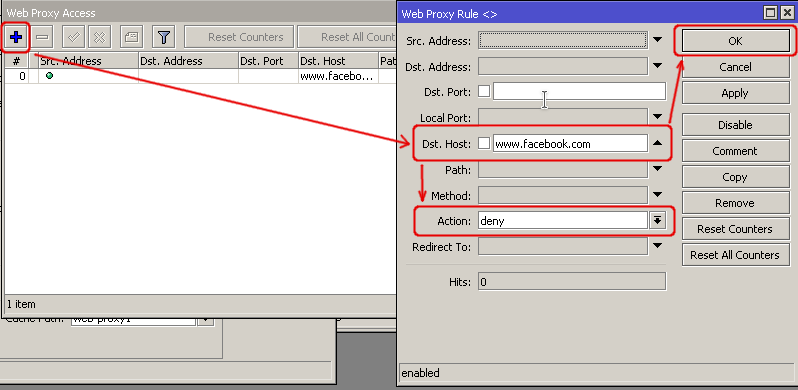

Blocking Unwanted Websites
In certain scenarios, you may need to restrict access to specific websites. For instance, you might want to block entertainment sites for employees or prevent access to inappropriate content. This can be accomplished by redirecting HTTP traffic to a proxy server and using an access list to allow or deny particular websites.
First, create a NAT rule to redirect HTTP traffic to the built-in proxy server running on port 8080:
/ip/firewall/nat
add chain=dst-nat protocol=tcp dst-port=80 src-address=192.168.88.0/24 \
action=redirect to-ports=8080

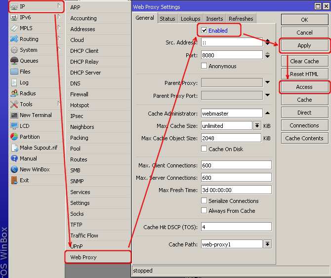

Next, enable the web proxy and configure access rules to block the desired websites:
/ip/proxy/set enabled=yes
/ip/proxy/access/add dst-host=www.facebook.com action=deny
/ip/proxy/access/add dst-host=*.youtube.* action=deny
/ip/proxy/access/add dst-host=:vimeo action=deny
Using Winbox
  • On the left menu navigate to IP -> Web Proxy.
  • The Web proxy settings dialog will appear.
  • Check the "Enable" checkbox and click on the "Apply" button.
  • Then click on the "Access" button to open the "Web Proxy Access" dialog.
  • In the "Web Proxy Access" dialog click on "+" to add a new Web-proxy rule.
  • Enter the Dst hostname that you want to block, in this case, "www.facebook.com", choose the action "deny".
  • Then click on the "Ok" button to apply changes.
  • Repeat the same to add other rules.
Troubleshooting
RouterOS has various built-in troubleshooting tools, like ping, traceroute, torch, packet sniffer, bandwidth test, etc.
We already used the ping tool in this article to verify internet connectivity.
Troubleshoot if ping fails
The problem with the ping tool is that it says only that the destination is unreachable, but no more detailed information is available. Let's review the basic mistakes.
You cannot reach www.google.com from your computer which is connected to a MikroTik device:
tip
If you are not sure how exactly to configure your gateway device, please reach MikroTik's official consultants for configuration support.
